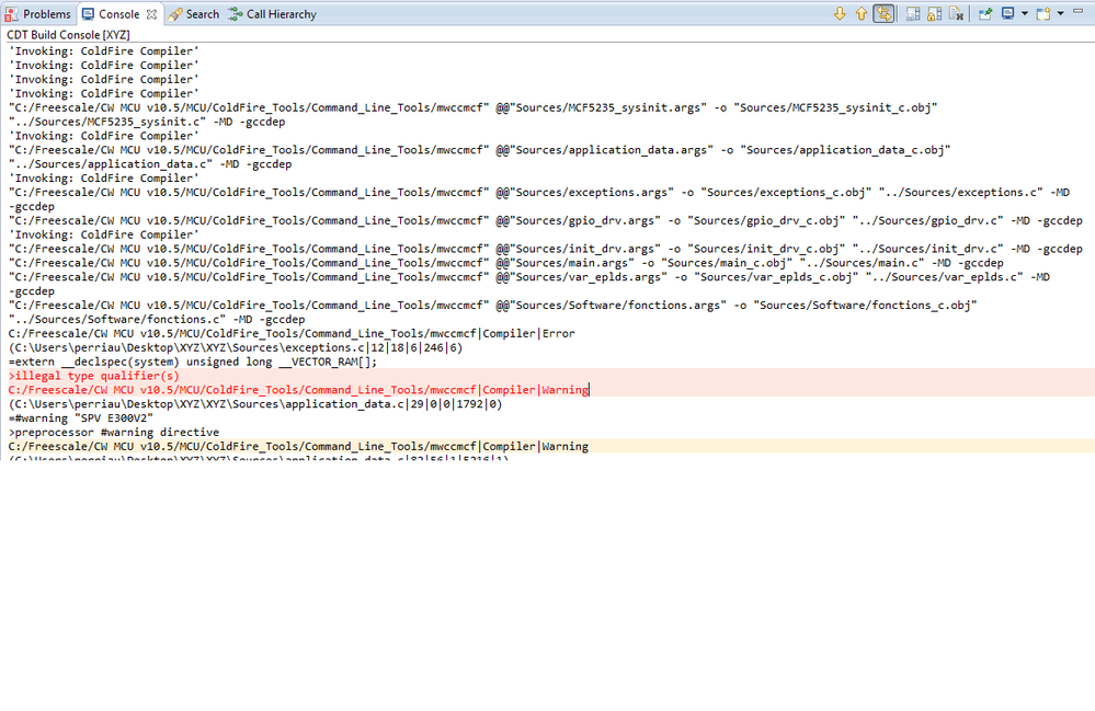

I migrate our software from CW7 to CW 10 on ecplis. evrering is working i connected our EPLD to MCF5235 led  are blinking.

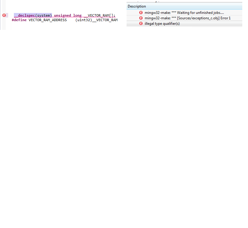

then i added all our file.h and i got an error. i never seen this error illegal type qualifier.
this error took place in exceptions.c file.
if someone have an idee do not hesitate to help me

thanks for your answer, we are moving from MCFV7.0 to MCU10.5
i look at the console but i don't realy understand

Regarding your problem with __declspec, please have a look to the attached doc.

Hi Fabrice,
Can I recommend to have a look to the Console component instead of the Problem one ?
The console will provide more information regarding the error.
