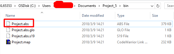

i want to use freemaster with codewarrior5.2 project.
but freemaster can't display variables and address when i load a MAP file.
i think ELF file is useful
how to create ELF file in codewarrior5.2  ???
2,543 Views
Hello yikun liu,
How about the *.abs file ?
Hope it helps
TIC
2,543 Views
yikunliu
it's useful !!!!
thank you verymuch~
