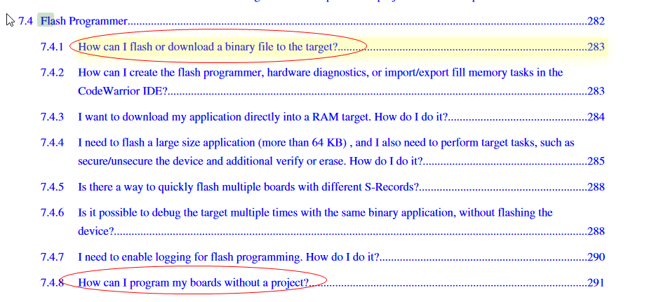

I was using Indart HC08 programmer for production using Datablaze programmer. But now it is damaged and I was suggested to use Multilink universal programmer. Can any one help me to find which software I should use for production purpose i.e. burn only hex file.

Hello pravin khisti,
You can use the flash programmer of  CW10.7 or CW11 :
https://www.nxp.com/support/developer-resources/software-development-tools/codewarrior-development-t...
And there is a guide tell you how to flash :
https://www.nxp.com/docs/en/supporting-information/CWMCUFAQ.pdf
espacially the Flash Programmer part :
Hope it helps
