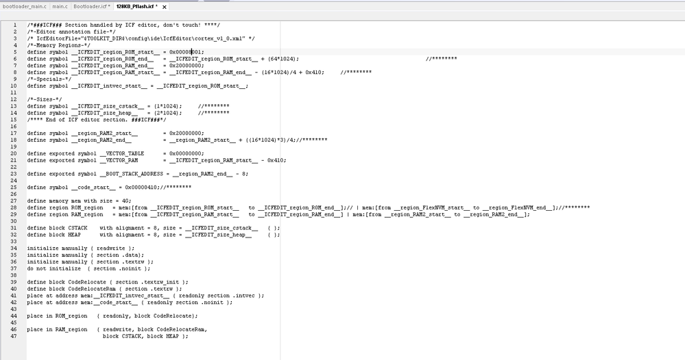

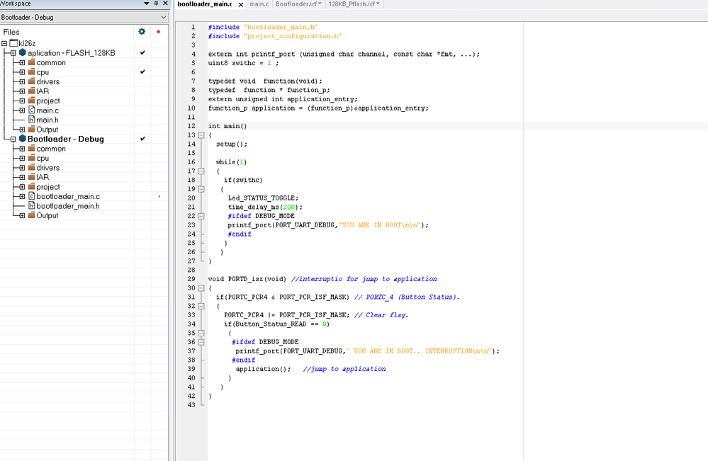

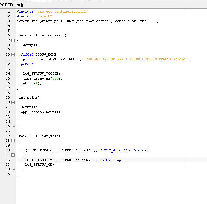

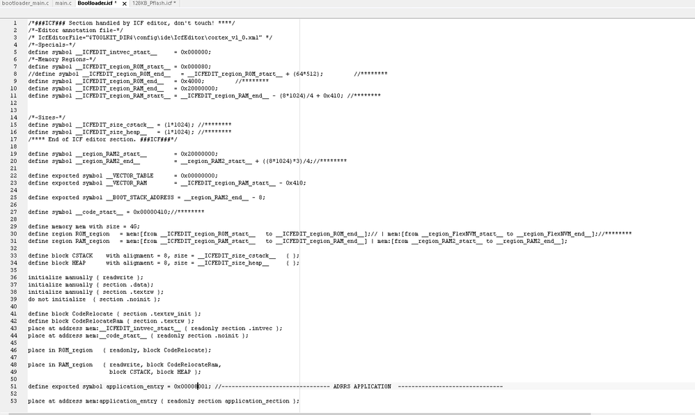

i would like to know if i should make something else in the .icf of the bootloader and the applicasion. because by activating the interruption to jump from the boootloader to the application, the kl26 stops and i have to turn it off and turn it on to return to function.
i do not know if you could give me a very basic example of how to make the bifurcation correct, i would thank you very much
these are the archives that e modifiedpastedImage_1.pngpastedImage_2.pngpastedImage_3.pngpastedImage_4.png
