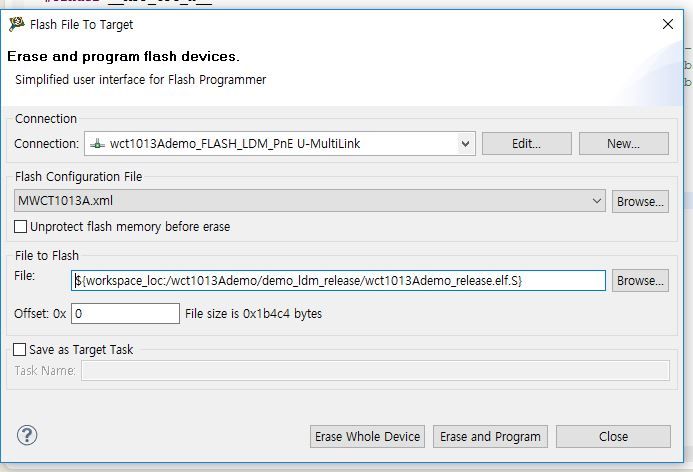

i use wct1013a.
I uploaded the bootloader and firmware using code warrior.
The bootloader works normally, but the firmware doesn't work normally.
What is mean 'No data to be programmed in selected flash memory range. '?
I set it up like this. Is there a problem?
Attached below is the log.

hi.
Thank you for your help. I solved the connection problem.
But the problem is the same. I'll reattach the log.

xiangjun_rong
Hi, Kim,
I suspect that the S-Recorder file format is incorrect.
I attach the screenshot, which tell you how to configure the S-Recorder file.
XiangJun Rong

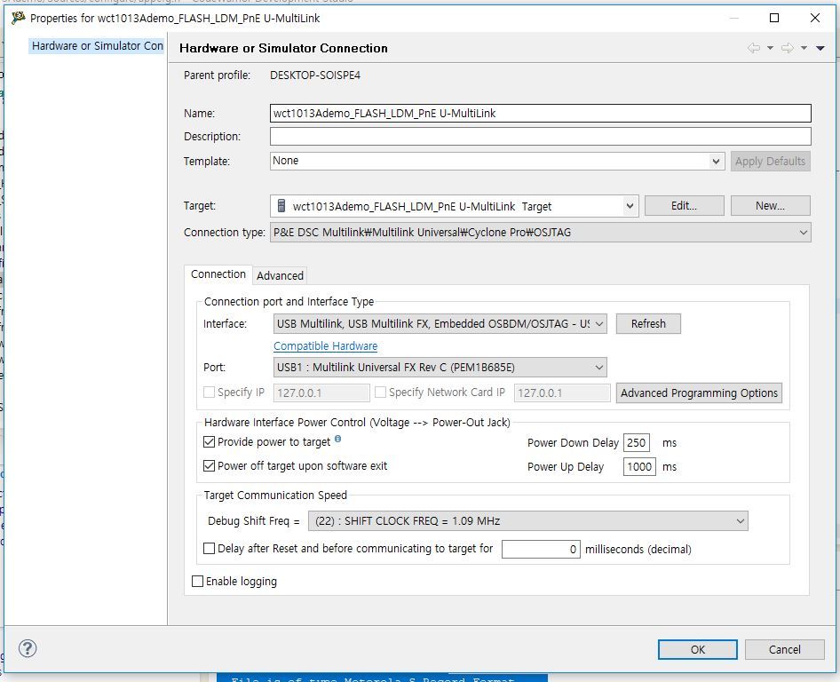

xiangjun_rong
Hi, Kim,
I have tried to download code to flash based on MC56F84789 based on usbtap device, no problem. I copy my log.
Regarding your issue, from the log, it appears that the multilink universal device has issue from the error message "Unknown Fault. The Debugger can not connect to the P&E device(GDI Procotol fatal error:)".
can you use usbtap device and have a try?
secondly, can you download the *.elf  file to flash with the CW for mcu ver11.c tools itself by clicking Run->Debug Configuration....?
Can you see the Multilink Universal device icon in Device Manager on PC?
Hope it can help you
XiangJun Rong
