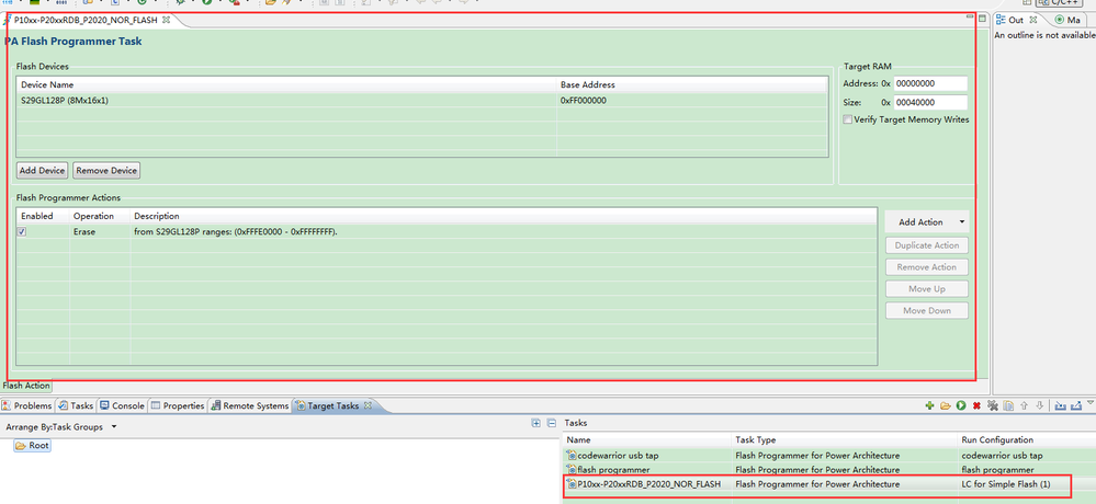

Thanks for your reply, my board is p2020rdb-pb.
1. According to your step, i configured like this:
but i find the button of "execute" is disabled, what's wrong?

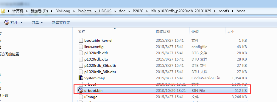

The log says:"Image size is 0 bytes, nothing to erase.   ",but my image's size is not 0 byte,what's wrong?

yipingwang
Hello Xu Chen,
Please refer to the flash programming procedure which I provided previously, please use SRAM launch configuration to connect to the target board first, then execute flash programming task.
Yiping

yipingwang
Hello Xu Chen,
In the "Add Program" panel, please check "Apply Address Offset", and specify the address as "0xFFF80000", and click "update Program Action".
If you problem remains, please provide the programmer log again.
