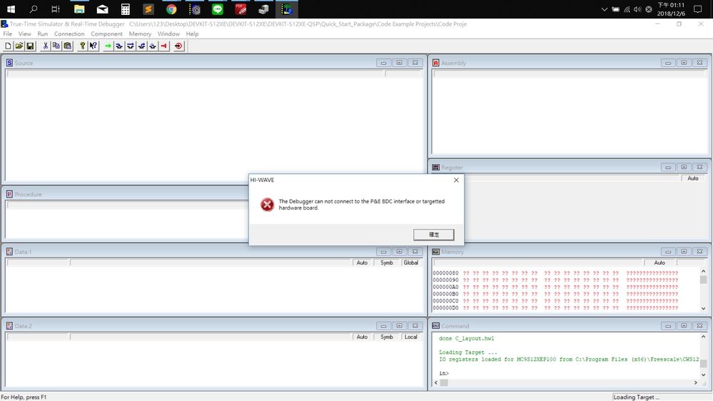

Hi  sir,
I am the beginner.
I bough the DEVKIT-S12XE demo board.
and download the "DEVKIT-S12XE-QSP" from the NXP website.
I build to open the "Lab1_KB_S12XE" project by IDE codewarroir 5.9.0, but it's failed.
the error massage below the photo.
thanks.
Edison.
1 回复
1,350 次查看
Hello edison wu,
From the error message, it seems connect board failed .
Please add a 12V power on J9 , also first create a simple new project , build, download to have a try.
