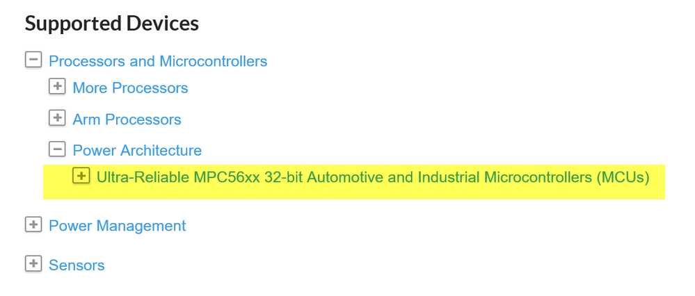

ZhangJennie
CW11 can support MPC56xx
https://www.nxp.com/products/processors-and-microcontrollers/additional-processors-and-mcus/digital-...
See supported Device:

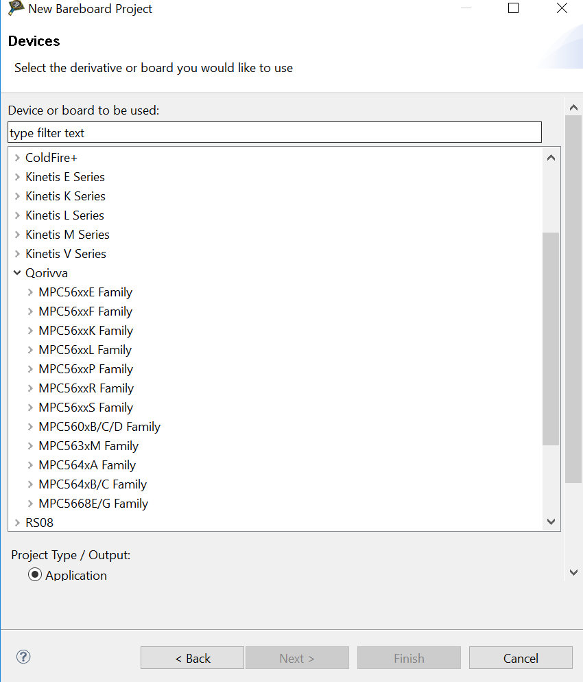

I just checked CW11 installed on my computer, I also see it
If you can't find the same on your side, I wonder you didn't select Qorivva during install CW.  Thus please reinstall it.
