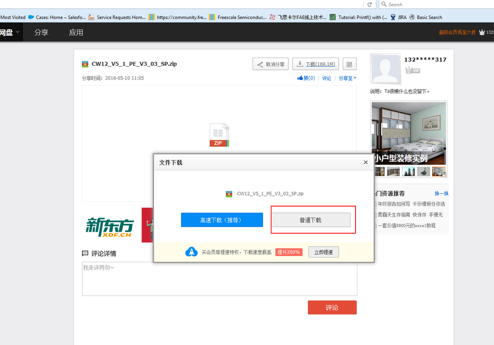

Hello Vinod,
Please download it at here : http://pan.baidu.com/s/1hsIw2aC
after click thin linker ,please click here :
And the cw5.1 does not support the Windows8 and Windows10, you can check the release note :
Freescale\CWS12v5.1\HCS12X_Quick_Start.pdf
Hope it helps
Alice

Hello ,
The CW12_V5_1_PE_V3_03_SP.exe is too large , it can not send by email also .
You do not need understand the web , you only need click it refer to the screenshot :
- About the DOC,  under the CW installation directory you can find , i also attach it for you.
- About the debugger , you can use these :
P&E Microcomputer Systems: Over 30 years as an Industry leader in Embedded Systems Development Tools...
Alice

rajkumarvinodka
Hi Alice,
I tried to do that, I get one more pop window from the website as shown below.
I don’t understand this. Where is this in the NXP website that I could downloaded?
