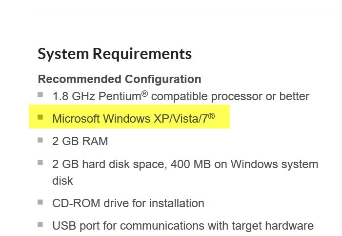

OS compatibility problem :
Code Warrior version : v2.1
OS : Windows 10 x64
I installed Code warrior ver. 2.1. on Windows 10 x64, and it can't executed on this environment.
The error log is attached as captured image.
Is anyone help this matter to solve?

Normally this error is because your CW components are not well registered.
Run file regservers.bat under your CW install folder can solve the problem.
But I am aware you use CW2.1. this version doesn't support win10 officially.
CodeWarrior® Development Tools for MPC5xx|NXP
Please use CW on our recommend windows platform.
