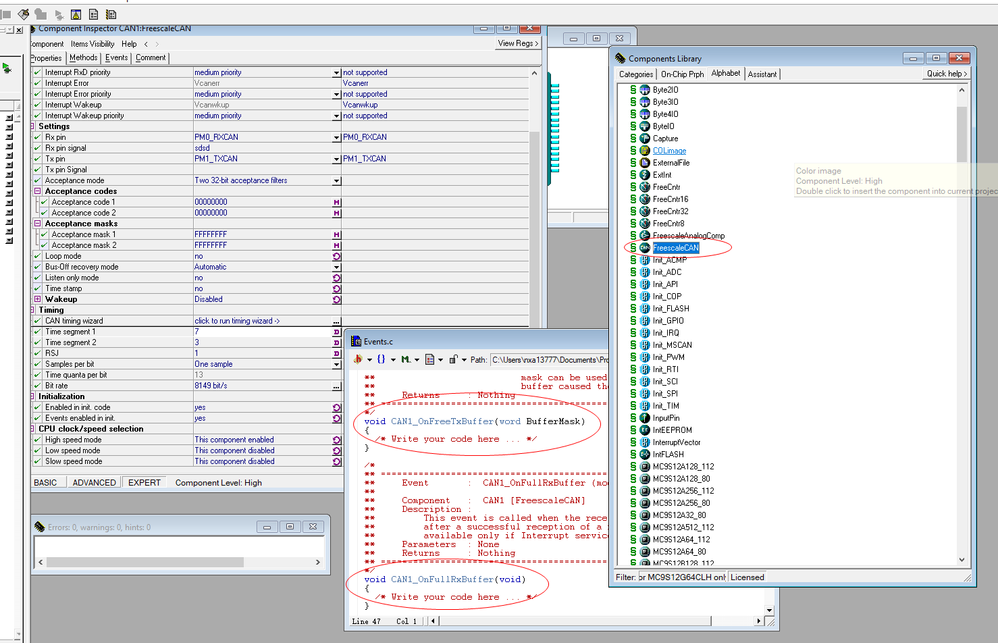

hi
   i want to use s12g64 mxCAN module,but PE can`t generate code completely
   E.g     no mxCAN rx/tx interrupt code in Event.c
              or  no External_clock_enable code in Cpu,c
   i need add  " setReg8(CPMUOSC, 0x80U);" in EntryPoint() when i use oscillator clock.
   but sometimes PE could cover my code in generate c file and i need to add " setReg8(CPMUOSC, 0x80U);" again.
   so angry
   i need help
   thank you
1,564 Views
Hello yikun liu,
Which License of CW do you used ? Special , Basic , Standard , Professional ?
If use Professional , you can use the  FreescaleCAN component,  it includes the interrupt code in event .c :
other versions only have the component of Init_MSCAN, this component only do some initialization function.
