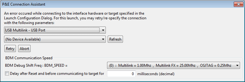

But when I simply follow the example from the quick start guide I already run into the issue that when I start debugging I cannot connect:
I'm using CodeWarrior 10.6.
The quick start guide instructions seem to refer to a previous version of CodeWarrior so the menu for setting up the project seems slightly different.
I played around with various debug settings but nothing seems to work.
How do figure out what the problem is?

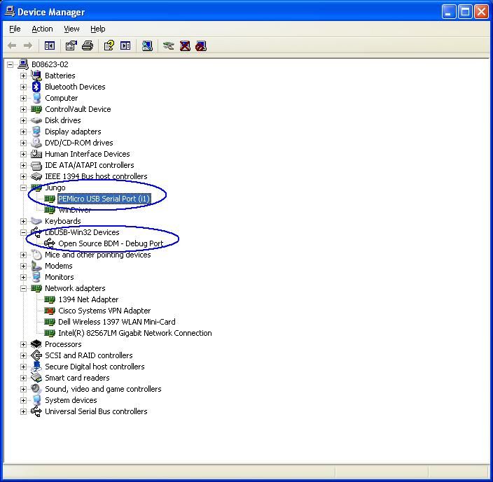

Please create a new bareboard project for 56F84789, then use the OSJTAG connection type to debug again, is there still any error?  I also need a screenshot of the Device Manager which shows OSBDM device, just as the attached picture.

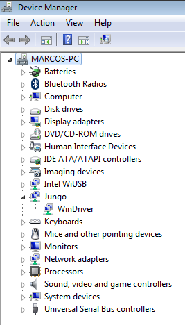

The screenshot from the device manager looks different for me:
I'm not sure which drivers I need to install.
I installed the ones I found here:  http://www.pemicro.com/osbdm/
but this did not change the behaviour.

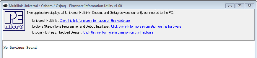

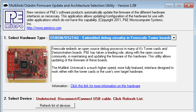

I also tried to detect or update the firmware but the respective tools do not detect the board, both with J17 open or closed:

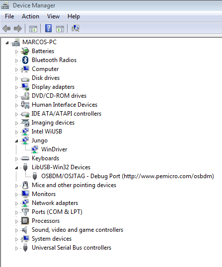

It seems it was an issue with the USB ports on my laptop.
With the first one I used, the installation of the OSBDM / OSJTAG drivers always failed.
I tried another USB port today and the installation was successful on that port.
Now the eval board can even be plugged into the USB port that previously did not work and is being recognised.
CW suggested a firmware update of the interface hardware and now debugging is possible.
Your suggestion to check the device manager lead me on the right track.
