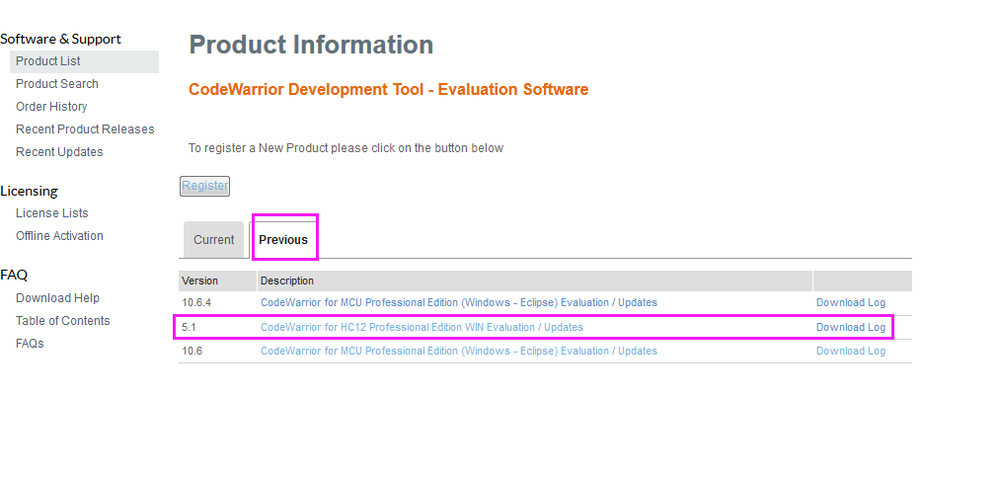

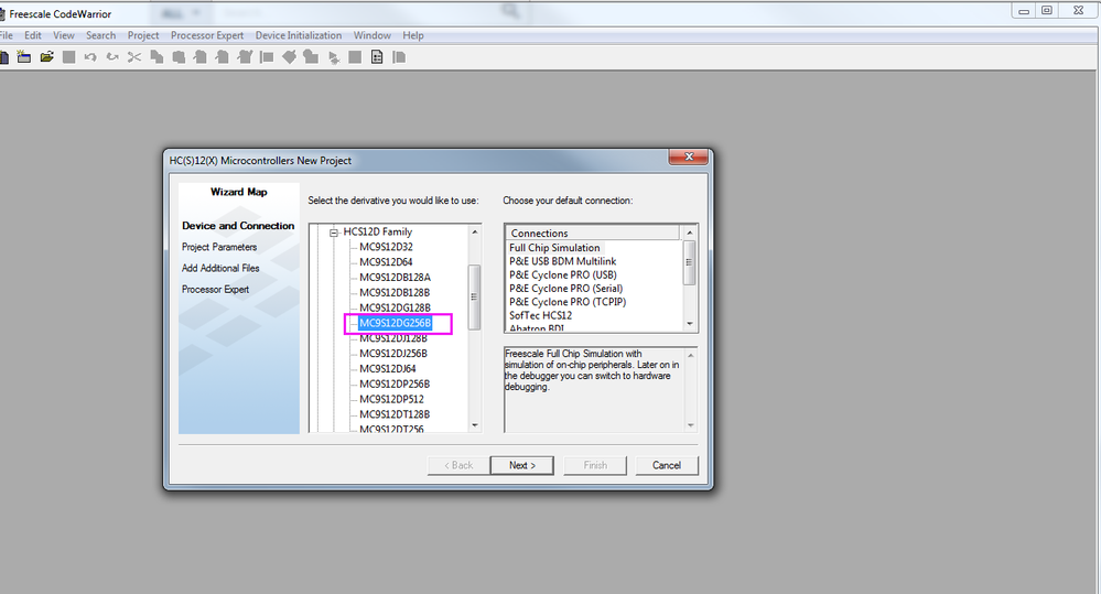

I have a Dragon12-plus2 HSC12 microcontroller trainer for University students which uses the MC9S12DG256 as the microcontroller and I am looking for which version of CodeWarrior will work with this? I have downloaded and installed CW_MCU_V6_3_SE, CWS12v5.2 and MCU v10.6.4 and none of these show the MC9S12DG256 as a supported device. Is there a version of CodeWarrior that supports the MC9S12DG256 or am I missing something?

Hello lyman,
Please use the CW v5.1.
You can download it at here :
https://nxp.flexnetoperations.com/control/frse/product?child_plneID=683911&cert_num=181625841&ver=AR...
After install it , you will see like this :
Hope it helps

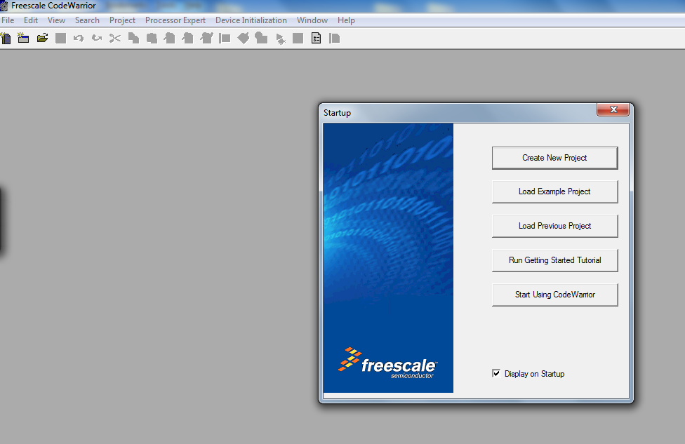

I had to reset my laptop and therefore had to reinstall CW v5.1
Since then, I am not getting the dialog for setting name and location of sample loads. I had sample projects that I wanted to load and run, it was working before the reset, but now i can't "name/location" any where. Repeated attempts at uninstalling/reinstalling prove same results.

Does Lyman,
Do you want this dialog :
If yes, please click File -> Startup Dialog...

lymantsinnie
Thanks for you help, but that was not what I was talking about. The areas where you name your project and location are missing. I had to reinstall and now when I open CW, those fields are missing.
I am running Windows 10. I have uninstalled, and reinstalled again but I still get the blank dialog. How can I completely remove CW? Would that be the issue?
