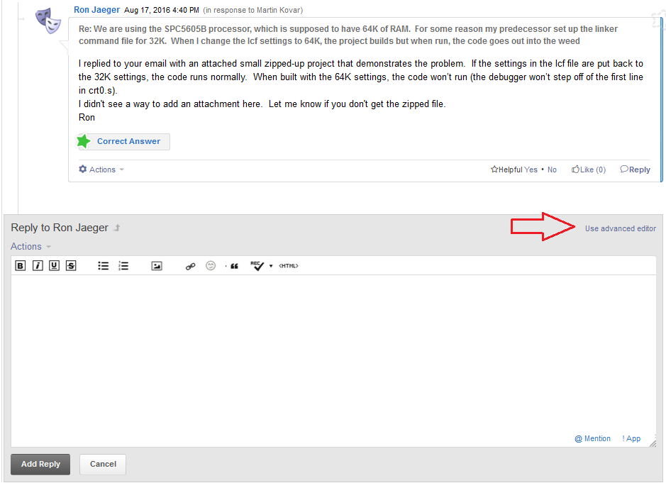

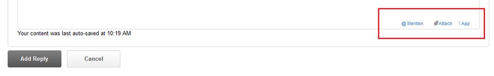

martin_kovar
Hi Ron,
I did not receive the project. If you want to add attachment, click reply, and choose Use advanced editor.
Now there is the option Attach.
Please share the project once again.
Martin
