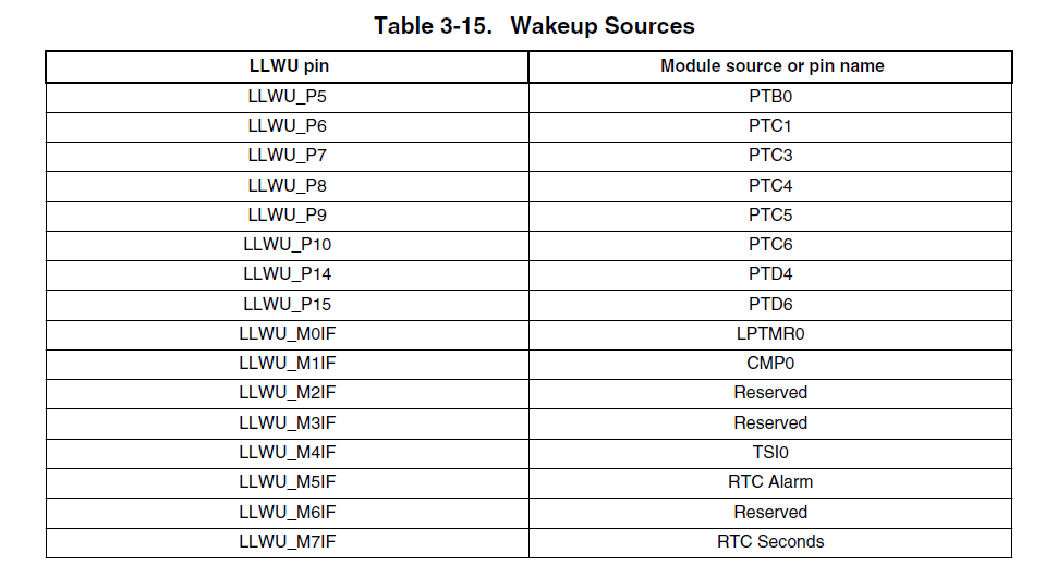

(1) The kineits L series produces support the maximum volt is 3.3V,
    so we can not use the 12v volt , must under 3.3 v.
  About the wakeup sources , you can check it at the reference manual :

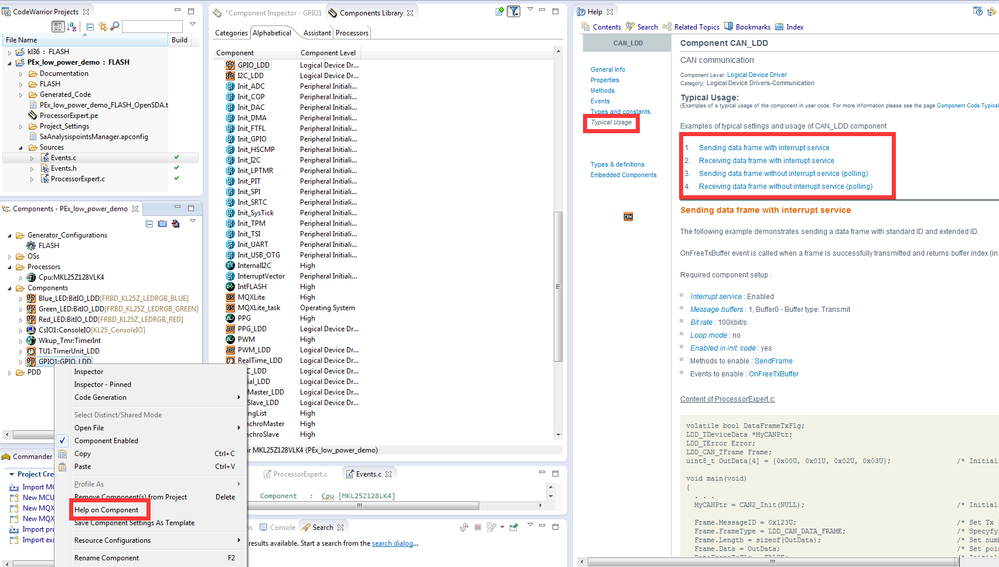

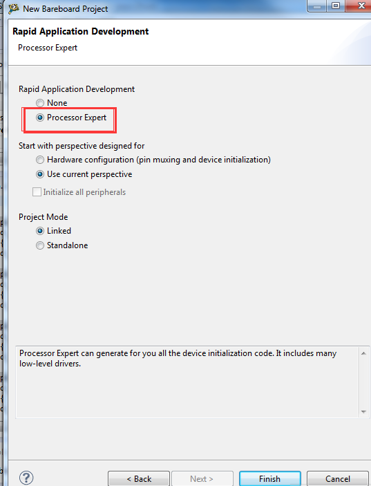

(2) About use the Processor Expert on CW, when you create project , please select it
Then about add one button , you can use the GPIO interrupt . So you can add the component
of "GPIO_LDD" component , then configure it refer to your requirement , about the usage example
of this component ,you can refer to the "Typical Usage":

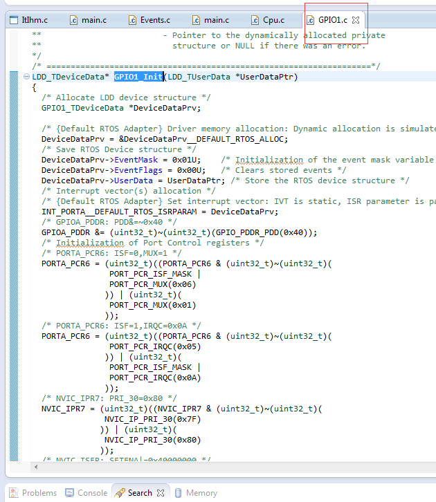

Hello Harold,
For example , we use the PTA6 as button .
After create one PE project :
add one component of "GPIO_LDD" , then configure this component :
After configure , click the "generate code " button :
Then  we can find the code rely on we configure :
About use the PE configure button (gpio) , have i describe clearly ? If not, please tell me .
And new to the PE, the "Help on component" (i mentioned last message)is very useful , it helps us how to configure and how to
write code .
