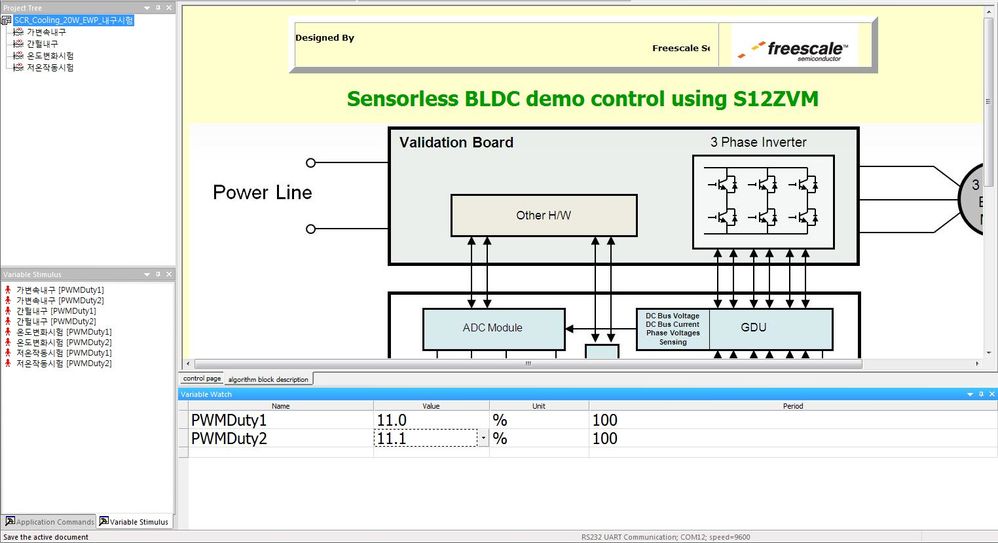

I used 2.0 version of FreeMASTER.
However, after I updated to 2.0.2, I cannot input decimal and odd number to real type transformation of Variable tab.
Would you help for this?
Thanks.

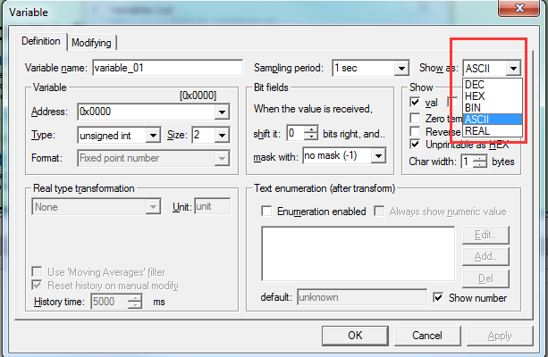

- Dose change this place can help you ?

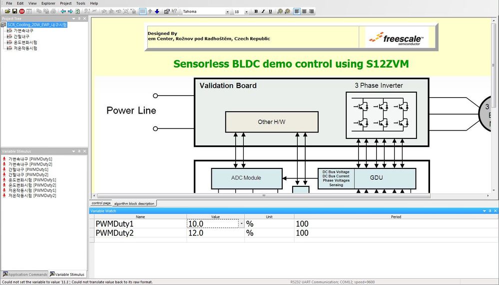

jtpark
Dear Alice,
Please see the below.
1. how to reproduce your problem?
--> I removed the FreeMASTER ver 2.0.0 using uninstall file. Then I installed the FreeMASTER ver 2.0.2.
After finish installing 2.0.2, start the '.pmp' file made of ver 2.0.0. Then, entered the value at the Variable Watch. I can enter the odd number and decimal(ex, 11, 11.1) in ver 2.0.0 but ver 2.0.2 can't.
I saw the similar question with my problem in NXP homepage and applied that manner. First, I made the new '.elf' file through build and debug in codewarrior. Then applied to new '.elf' file in FreeMASTER ver 2.0.2 but wasn't change anything.
2. problem screenshot.
-->Please attached file.
-->I don't understand what you are saying. Please the explain more detail.

jtpark
Dear Alice,
I added your answer.
-->Please see the below.
    I use the real type transformation. So, I can't change the other type.
Thanks.

agostinofacotti
Hi J.T. Park,
I've the same problem as yours with Freemaster 2.0.2 (see https://community.nxp.com/thread/435986 ) but using linear interpolation instead of two point: in my case Freemaster accepts only values that transformed-back gives an integer number.
agostino
