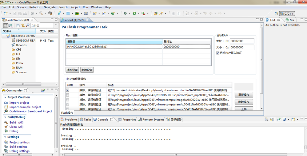

   i use code warrior 10.4.0, i down uboot ,but the type information display as fallow
console message as fallow
fl::target -lc "ktppc5043-core00_RAM_8309_Download"
fl::target -b 0x2000 0x60000
fl::target -v on -l off
cmdwin::fl::device -d "NAND02GW-eLBC" -o "256Mx8x1" -a 0x0 0xfffffff
cmdwin::fl::image -f "C:\\Users\\Administrator\\Desktop\\down\\u-boot-nandzhu.bin" -t "Binary/Raw Format" -re on -r 0x0 0xfffffff -oe off
cmdwin::fl::erase image
Beginning Operation ...
Performing target initialization ...
Error: Connect Failed.
Could not connect to the probe (or other debug link)
[CCS last error: CC config string is invalid ](CCSProtocolPlugin)

Error: Failed reading return status. Can not read target memory at location: 0x00000000000094D0.Please make sure that the chip selects are properly configured.
The CWPP response code is: CCSProtocolPlugin : Error reading memory
[CCS last error: Core not responding ].

could you tell me how to solve it .
Thanks.

Hello Wei Yang,
1. Please select "Apply Address offset" and specify the u-boot location in the flash programming task configuration panel. You could refer to the document Flash Programmer for CodeWarrior Power Architecture .
2. Have you modified DDR controller configuration in CW configuration file according to your target board? Please create a sample "Downlaod" CodeWarrior project for MPC8309 demo board, and configure the initialization file as yours from Run->Debug Configuration-><project>-core00_RAM_8309_Download->Edit->Edit->Initialization, then verify whether this sample program can be executed on your target board successfully.
3. Have you modified the local bus configuration section in CW initialization file according to your target board?
