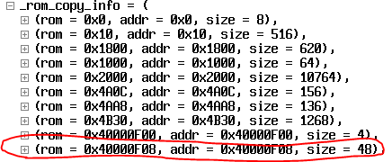

Hi all,
I am working using CW_for_MPC55xx_and_MPC56xx_2.10
I have an initialized variable "numOfTests" that is mapped to RAM. As you can see in the attached linker file (XPC560XB_flash.lcf).
As it is an initialized variable, then it will be mapped to the ".sdata" section (small data with read/write permission).
uint16 numOfTests = 14;
So after flashing the ECU using a debugger, the value of "numOfTests" will be in ROM.
And to get the correct value, during startup, I need to copy that value from ROM and store it at the address of the variable "numOfTests" in RAM.
The variable "numOfTests" has an address "0x40000f08" as you can see in the attached map file (PA_XPC560XB_FLASH_ConTest_Standard.MAP).
I looked up in the example codes provided by Freescale, and I found the function "__init_data" in the "__start.c" file.
I added this file to my project, alongside other dependent files (__mem.h__ppc_eabi_init.c__ppc_eabi_init.h__ppc_eabi_linker.h -> all attached) and it compiles.
As I understood from the code, there is a table "_rom_copy_info" that is mapped to the section ".init":
__declspec(section ".init") extern __rom_copy_info _rom_copy_info[]; /* An array of all initialized (data, text or mixed) sections */
As i guess and I don't know how, but this table is generated by the compiler.
When debugging :
The table "_rom_copy_info" has wrong values.
As we see below the rom is equal to addr (ram)
having this case and the condition in the function "__copy_rom_section" :
if (size && (dst != src)) {
memcpy(dst, src, size);
__flush_cache( dst, size );
where :
  • dst = addr
  • src = rom
  • size = size
Then the values of section ".sdata" will never be copied from ROM to RAM.
My questions are:
  1. Am I using correctly the example code?
  2. Am I defining correctly the sections in the linker file?
  3. How the compiler generates the variable "_rom_copy_info"?
  4. How can I know where are the values of the ".sdata" section are flashed in ROM, so I can manually copy them to RAM?
  5. is there a solution to my problem ?
PS: I also attached the compiler's options (PA_XPC560XB_mwerks_cfg.mak)
Thank you
Maher

martin_kovar
Hi Maher,
Unfortunately, I do not know all your project, because you use your own settings (startup, linker, etc.), but from the files you shared, I am not able to find any misconfiguration, but I am not sure about your linker file.
When you look at the map file, you should see that sdata in ROM are flashed at address 36b0.
I am sharing very simple project created in CW2.10 (default project), so please look at it and focus on the following points:
I have created global variable int numOfTests = 14;
This variable is places in sdata section, address 40001340.
If you look at the another part of map file you should see following:
Section sdata starts at address 4001340 in RAM and at address 2800 in ROM.
Variable rom_copy_info looks like this:
The "project" or the files you shared here are too complex to looking for what is wrong. So if I find a bug, please create as simplest project as possible, which demonstrates your issue and share it here. Then I will be able to tell you, what can be wrong.
From my point of view, the best way is to take my project and try it on your side. If it works, do the small changes with linker and startup code and watch, if it still works. This could help to discover the source of your problem.
Martin

mahermalak
Hi b55689‌,
Thank you for your reply.
Concerning creating a project using the IDE, I am not sure if it can help because I am using the compiler via command line.
And I am not what does the IDE do in the background (ex: list of compiler's options, entry point...).
I opened your project and I saw that you are using the linker's flags : -rambuffer & -romaddr.
And I saw that you used the address of internal flash : 0x3000.
So i did the same and I put the init section outside of the group "mtextboot" and now I have the impression that the variable "__copy_rom_section"  has the correct values:
and at the address 0x5848 we can see the initial value of "numOfTests" 14 = 0xE
which is great.

when adding the attribute "BSS" in the declaration of this section in the linker, like this :
  .noinit (BSS): {} > section_noinit /* RAM no init */
But the variable mapped to this section are mapped to the "sbss" section !!!!
