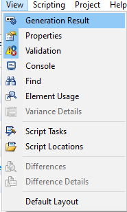

I have configured GPT driver, MCU driver and ECUM module using Vector DaVinci Tool. MCU and ECUM are getting generated successfully but GPT is generating error as
"Tresos79001 tresos_cmd.bat has returned the ExitCode 1 during Validation"
All the container and parameter for GPT driver are configured but I am not able to get why the tool is generating Validation error. Can you please support me to resolve the Validation error.
ECUM, GPT and MCU configuration files are attached for reference.
ECU: S32K144

Dear Gowthaman,
Yes, I have resolved the issue.
Since these issue were related to Thirdparty configuration and DaVinci was not able to show the proper validation error, so to view the validation error for Thirdparty we need to use Generation Result option as shown below and after that try to solve the validation error.
