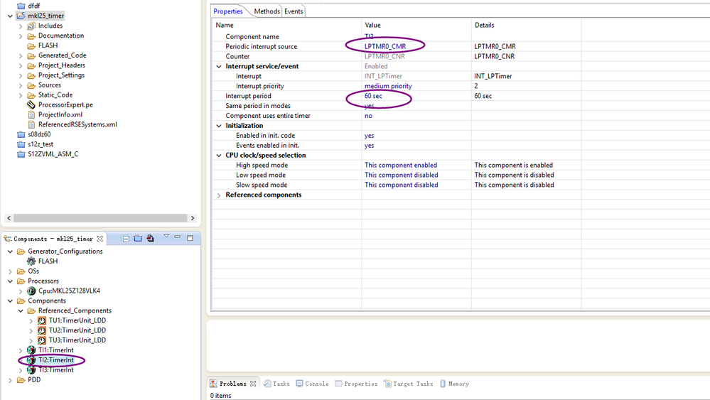

I need some advice on which processor expert component to use with CW10.3 KL25Z.
I need 3 timers 25,45,60 seconds, after each timers expires I need the program to "do something".
I need the timers to run in the background and not interfere with the program running and checking my other conditions.
What processor expert components would be the best for this job?
Any tips on settings and set up will be appreciated.

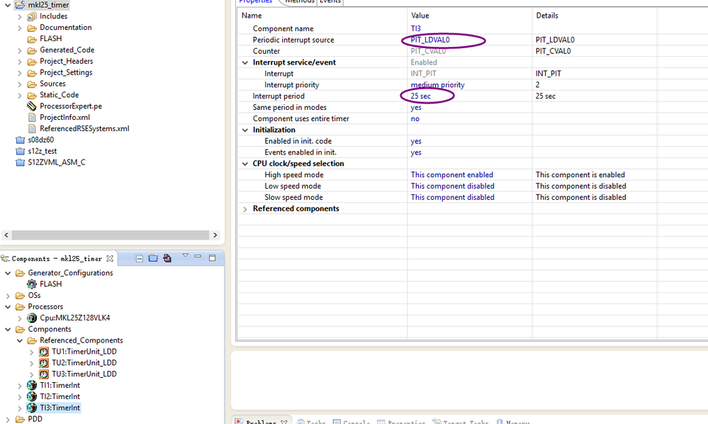

Hello Anthony Verfaillie ,
You can use "TimerInt" component, then configure the proper timer , for example :
TIC
