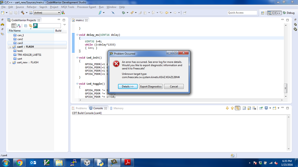

I was working with the projects in code warrior ide.
The same IDE when I started today is displaying some error.
I have attached the screen shot of that error. With this error I cannot debug or the flash the code, but I am able to compile the code.
Please let me know what has happened suddenly for the code warrior to behave in this manner.
Thanks in advance.

Hmm, to me it seems like your installation got corrupted somehow.
I would try to install a new instance of CodeWarrior (you don't have to uninstall your current version) and try if this helps?

Yeah Erich.
You are right.. It seems to be that the IDE has corrupted.
