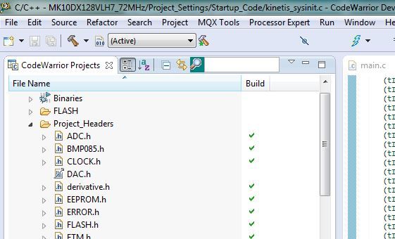

Hi at all,
Does anyone know, why there is a problem to creat a DAC.h Header file?
Any other names of header files are possible to creat, but when I try to write DAC.h
the CW 10.6 shows the following error picture to me... but it works without any problems...
When I change the name to DAC1.h or something else the error picture disappears...

That means you have still custom options/settings for that file.
You need to reset the resource configuration to the default.
See
http://mcuoneclipse.com/2013/06/12/traps-and-pitfalls-no-hexbins19-file-created-with-gnu/
(image: http://mcuoneclipse.files.wordpress.com/2013/06/reset-to-default-on-sources-folder.png?w=584&h=213)
I hope this helps,
Erich

See http://mcuoneclipse.com/2012/07/30/icon-and-label-decorators-in-eclipse/
That icon decorator means that you have excluded that file from build. Nothing bad happens as this is a header file.
See Exclude Source Files from Build in Eclipse | MCU on Eclipse how to exclude (or in your case) to include that file again.
I hope this helps,
Erich

okay thats works! But now, there is a little key in the picture... Do you knwo how to fix that?
Thanks :smileywink:
