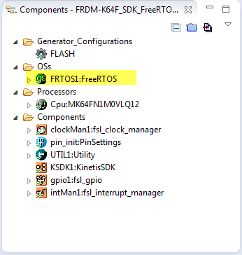

I'm now trying several way to program my FRDM-K64
Using Processor Expert with KDS I can use only MQX for SDK but it is in beta and have sveral bug, now I'm trying to use FreeRTOS
I see that I can install, with KSDK1.0.0 the FreeRTOS 8.0 and it is a stable version.
I try to use Processor Expert on my KDS 1.1.1 for use FreeRTOS (v8.0 installend with KSDK) instead MQX-sdk.
But there is not the component! What I can do? I downloaded a componente from web bnut use a FreeRtos 7.2.0 version (that I not have and it is impossible find a previously version on web of FreeRTOS) but it don't work...
I only want to use FreeRTOS installed during KSDK installation with processor expert, what I can do?

Hi Max,
The McuOnEclipse FreeRTOS Processor Expert component (Tutorial: Freedom with FreeRTOS and Kinetis-L | MCU on Eclipse) works with the Kinetis SDK too. It looks like this:
The only difference is because the SDK needs some special user types, you need to add the KinetisSDK component to the project (see screenshot).
I have attached for you a LED blink demo for the FRDM-K64F board with FreeRTOS and the SDK.
If you do not have the McuOnEclipse components, you can download them from here:
https://sourceforge.net/projects/mcuoneclipse/files/PEx%20Components/
Unpack the zip file, then import the *.PEupd files with the menu Processor Expert > Import components.
As additional ressource, go to Freescale Technical Sessions Library|Freescale and search in the library for FreeRTOS: you will find FTF-SDS-F0120 on that subject.

Hi Max,
The McuOnEclipse FreeRTOS Processor Expert component (Tutorial: Freedom with FreeRTOS and Kinetis-L | MCU on Eclipse) works with the Kinetis SDK. It looks like this:
If you do not have the latest McuOnEclipse Processor Expert components installed, you can get them from here:
Download and unpack the zip file, then import the *.PEupd files with Processor Expert > Import Component(s).
See Processor Expert Component *.PEupd Files on GitHub | MCU on Eclipse how to import them into your KDS or DriverSuite Eclipse.

ZhangJennie
hello max
from my understanding, current KSDK1.0.0 FreeRTOS can support GCC, Keil, IAR but no KDS yet.
i suggest you use KSDK+MQX+KDS instead.
Zhang Jun
