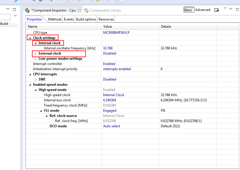

Hi Carlos,
If you not sure how configurate the clock and how to initialize ,you can firstly use the Processor Expert configuration , and there also have "help component "can check the meaning of the related compenet.
  it is convenient . It is configurate like this :
The CPU clock select :

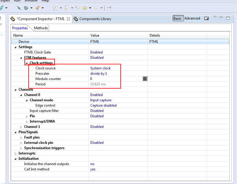

The FTM clock configuration :
Alice
