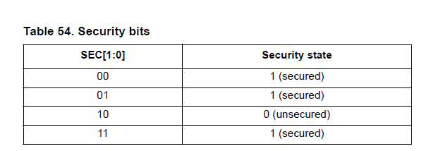

Hi,all
I download the program into the microcontroller(MM9Z1J638) by multilink universal. But  a problem accurs, The console is as follows,
I don't know what's wrong with my operation.
expect to get the result soon !
fl::target -b 0x1000 0x2000
fl::target -v off -l off
cmdwin::fl::device -d "MM9Z1J638_FLASH" -o "128Kx32x1" -a 0xfe0000 0xffffff
cmdwin::fl::image -f "E:\\BMS 638 System\\RD9Z1-638-4Li-SW_Rel1.03\\MM9Z1J638\\RD9Z1-638-4Li-Sw.elf" -t "Auto Detect" -re on -r 0xfe0000 0xffffff -oe off
cmdwin::fl::erase image
Beginning Operation ...
Auto-detection is successful.
File is of type Elf Format.
Performing target initialization ...
Device MM9Z1J638_FLASH is protected
Erasing ....
Error: Erase Command Failed. Operation timeout. Security area should not be programmed with a value that leads to irreversible secure
. Protect violation error.
An invalid preference was passed to the GDI protocol plugin(HC/RS/S12Z GDI Protocol Adapter)
Error: Erase Command Failed.Operation timeout. Security area should not be programmed with a value that leads to irreversible secu
re

Hello Li zhi,
Through  the information of Console , it seems the chip is security ,
The security features of the S12Z chip family are :
•Prevent external access of the non-volatile memories (Flash, EEPROM) content
•Restrict execution of NVM commands
•Prevent BDC access of internal resources
In the chip register , there are two bits are used for security (SEC[1:0]), then set the tow bits to 10 ,
it unsecured.
About the detail please refer to Data Sheet of  your chip,    the part of  "5.2.7Security "
Hope it helps

Hello LI Zhi
- I just guess maybe it is the security problem.
If it is the security problem, it is not the project you now want to download , it is
the reason of the project which exist in your board . You can first erase all the chip,
then download your project to have a try.
- About the security :SW example of Security feature with Backdoor Access Key option for S12ZVL MagniV microcontroller
Alice

lizhi
Hello,Alice
anotner noticed thing is that a window pop up said  "Device is secure.Erase to unsecure?"
In fact,I first use the Codewarrior 10.6. So Could  you tell me how operating to erase all the chip .
thankyou.
3,606件の閲覧回数
Hello Li Zhi,
When it shows "Device is secure.Erase to unsecure?" , please click "Yes".
Alice
