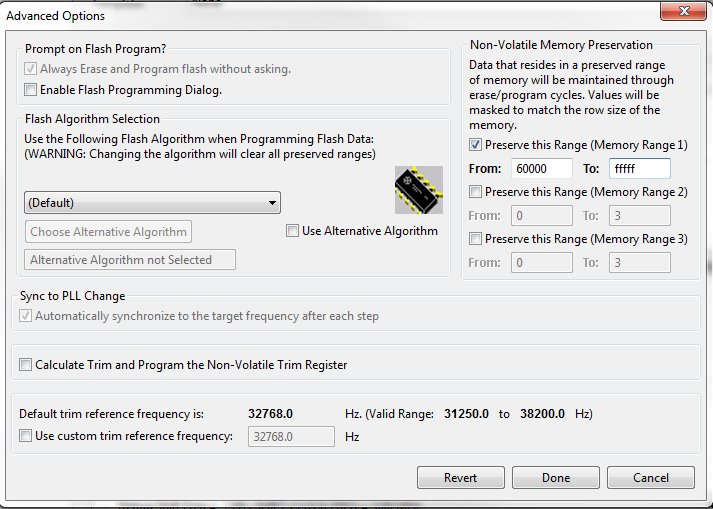

I have K60 tower board, and am using Code Warrior 10.6.4 with MQX 4.2
I am using part of flash memory for system configuration. System Configuration data is saved. But every time if I reload firmware, the data is cleared. So I want to exclude 0x60000 to oxFFFFF flash memory and only designate 0x0 to 0x60000 for code area. It works if it is release build. (See Advanced Options below). But for debug mode, the debugger aborts after the Preserve this Range (Range1) is checked and sets to from 0x60000 to 0xFFFFF.
Second: Now the debugger desn't work even if Preserve is unchecked and addresses boxes are reset to 0x0. I have to create a new debug connection to fix the problem.
Thank you,
David Zhou

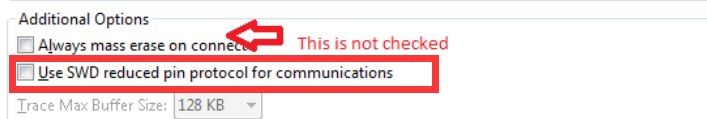

Hello David,
In the normal mode , do not preserve some range, does it can download successful ?
If not,  please first test a simple project , and do you use the SWD or JTAG debug ? If
SWD, please check it :
I see you use the K60F120 chip, i also test on it, also use the Multilink Universal FX revB,
it can work well . So i recommend you carefully re-open CW, connect , configure it .
Alice

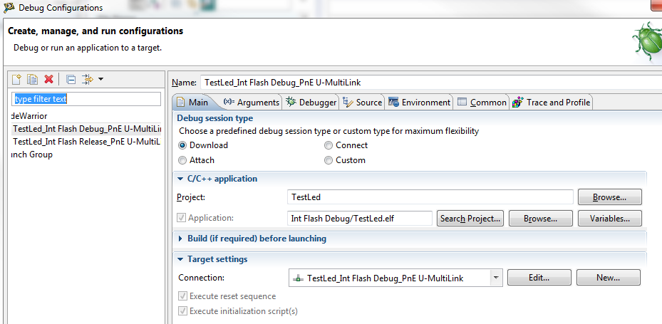

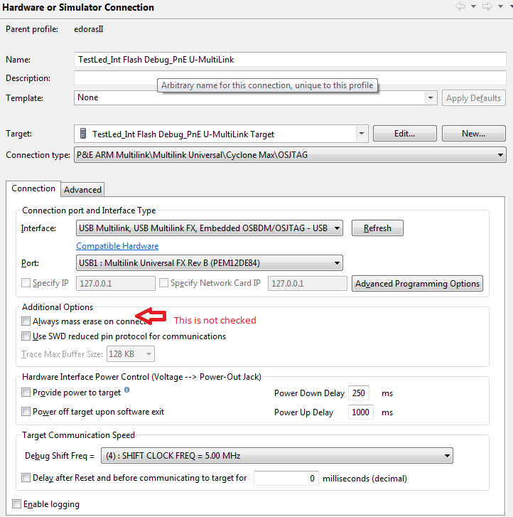

Hello David,
Please check the debug configurations view , do not enable the "Always mass erase on connect":pastedImage_1.png
I test a simple project use the debug mode to have try , it can work well , please see the video and the project.
In the  demo , i first place the function "RedLed()"into 0x75000, at the second download , i delete these this function in mian(),
then download , we can see the data in 0x75000 not changed.
You can also test the simple project first on your side ,if it can now work , please show me the steps and
configurations .
And if you can not connect the board now , please delete the .metadata folder under CW workspace,
then re-open the cw to test again.
Hope it helps
Alice Yang

For some reason, it didn't work for me.

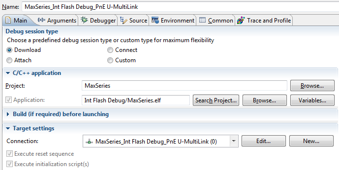

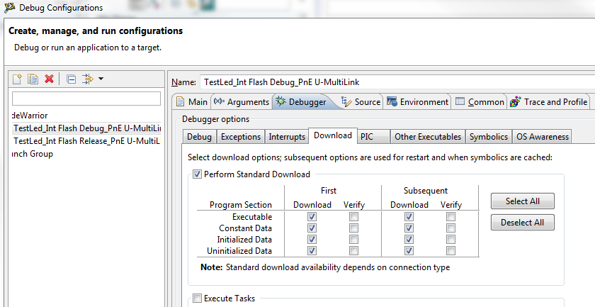

I posted all the configuration screen saved:

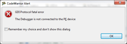

The console output during the start of debug session, it has messages indicating 0x60000 - 0xFFFFF was not erased. It runs and stops at debug break point. But after that it pops up a window and aborts debug session:
Here is the configurations:
I have tried several projects. It downloads, runs, stopped, but ABORTS the debug session (configuration data IS PRESERVED!).
Thank you for your support.
David Zhou

I found the problem:
Certainly, that shields some MQX OS debugging capabilities. But it works to preserve some flash memory and still be able to debug.
