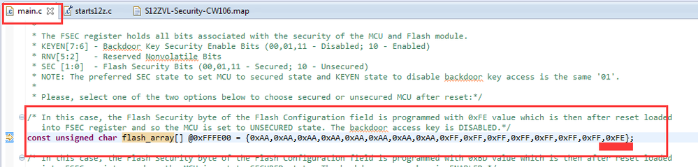

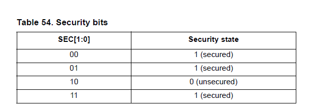

Hello Li zhi,
Through  the information of Console , it seems the chip is security ,
The security features of the S12Z chip family are :
•Prevent external access of the non-volatile memories (Flash, EEPROM) content
•Restrict execution of NVM commands
•Prevent BDC access of internal resources
In the chip register , there are two bits are used for security (SEC[1:0]), then set the tow bits to 10 ,
it unsecured.
About the detail please refer to Data Sheet of  your chip,    the part of  "5.2.7Security "
Hope it helps

Hello LI Zhi
- I just guess maybe it is the security problem.
If it is the security problem, it is not the project you now want to download , it is
the reason of the project which exist in your board . You can first erase all the chip,
then download your project to have a try.
- About the security :SW example of Security feature with Backdoor Access Key option for S12ZVL MagniV microcontroller
Alice
