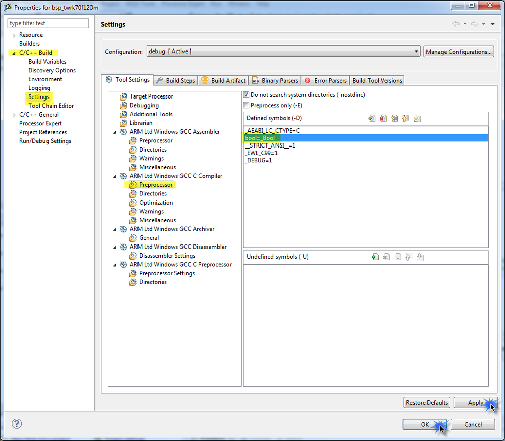

Anyone know why Processor Expert is generating this error with Processor Expert Generated code?
"conflicting types for 'ExtIntLdd1_GetVal'.
I'm using MQX 4.1, CW10.6, K70 processor.  I've added an ExtInt_LDD component, and when I select toggle Enable/Disable GetVal(), I get this error.
Thanks in advance.

Hi Louie,
In order to fix this error please try the following:
- Go to menu Project > Properties.
- Select C/C++ Build > Settings and open the Tool Settings tab.
- Navigate to ARM Ltd Windows GCC C Compiler > Preprocessor.
- Add the following definition in the Defined Symbols: bool=_Bool
- Clean and Build the project.
Hope it helps!

louiemoye
Excellent!  That solved the problem.
