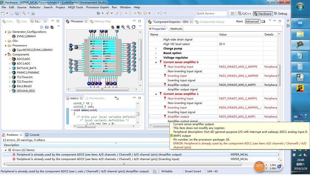

I use the Processor Expert to configuer both ADC1 module and GDU module for my MC9S12ZVML128 project,and I would like to take the pin PAD5_KWAD5_AN1_0_AMP1 as a conventional AD input port for ADC1 module instead of the current sense amplifier 0 input port for GDU module.But there is an error such as the picture below:144797_144797.jpg1.jpg

Hello ZHANG,
The error massage have reminder you that the ADC component and the GDU component
use the same pin PAD5_KWAD5_AN1_0_AMP1 , they colide , can you change one pin to another ?

    I know when the same pin uesd by two different components there will be a Conflict error. But I want to set the pin PAD5_KWAD5_AN1_0_AMP1 as a conventional AD input port for ADC1 component .I don't want to use it as the current sense amplifier  input port for GDU component. when I configure the GDU component, this pin used by the GDU current sense amplifier automatically. I want to know how to disable the current sense amplifier in the GDU component ? It seems to be a software bug.

Hello ZHAUG,
- In the component of GDU component , the  AMP1 can't disable ,
for there is no routing register for it .
- For the AMP1 priority if higher than ADC , so when use the GDU,
the pin of PAD5_KWAD5_AN1_0_AMP1  can not used to ADC.
Hope it helps
Alice
