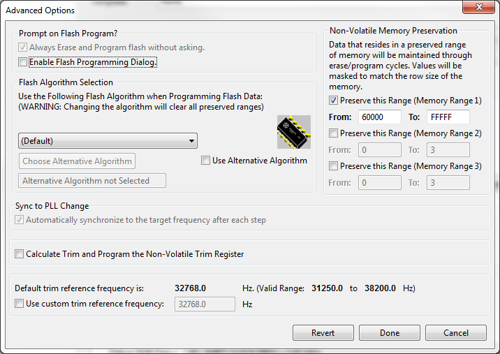

I have K60 tower board, and am using Code Warrior 10.6.4 with MQX 4.2
I am using part of flash memory for system configuration. System Configuration data is saved. But every time if I reload firmware, the data is cleared. So I want to exclude 0x60000 to oxFFFFF flash memory and only designate 0x0 to 0x60000 for code area. It works if it is release build. (See Advanced Options below). But for debug mode, the debugger aborts after the Preserve this Range (Range1) is checked and sets to from 0x60000 to 0xFFFFF.
Second: Now the debugger desn't work even if Preserve is unchecked and addresses boxes are reset to 0x0. I have to create a new debug connection to fix the problem.

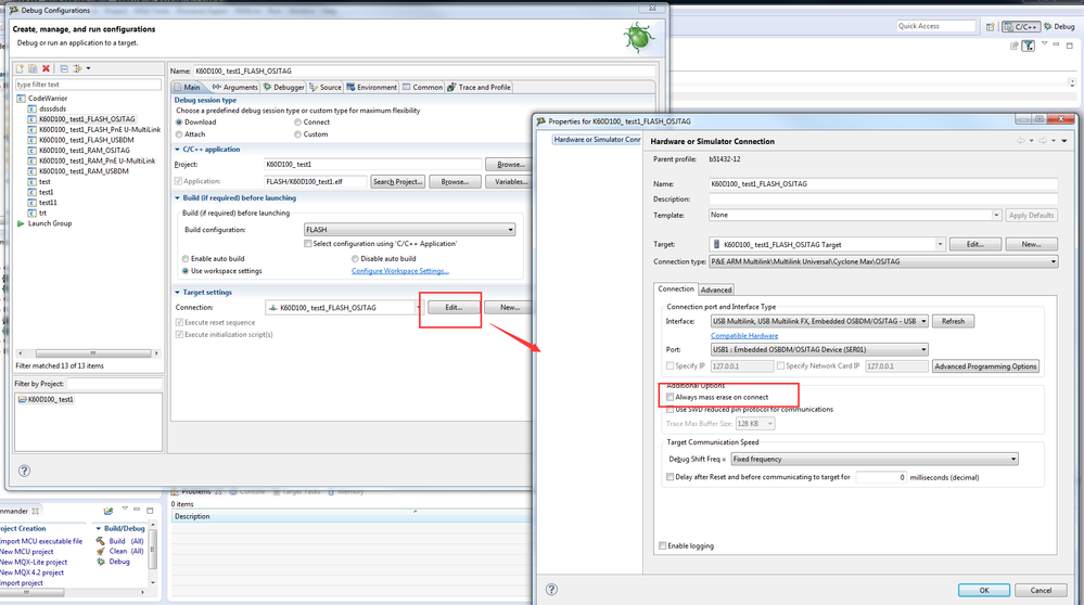

Hello David,
Please check the debug configurations view , do not enable the "Always mass erase on connect":pastedImage_1.png
I test a simple project use the debug mode to have try , it can work well , please see the video and the project.
In the  demo , i first place the function "RedLed()"into 0x75000, at the second download , i delete these this function in mian(),
then download , we can see the data in 0x75000 not changed.
You can also test the simple project first on your side ,if it can now work , please show me the steps and
configurations .
And if you can not connect the board now , please delete the .metadata folder under CW workspace,
then re-open the cw to test again.

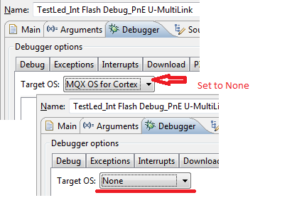

Hi Alice,
I found the problem:
Certainly, that shields some MQX OS debugging capabilities. But it works to preserve some flash memory and still be able to debug.
