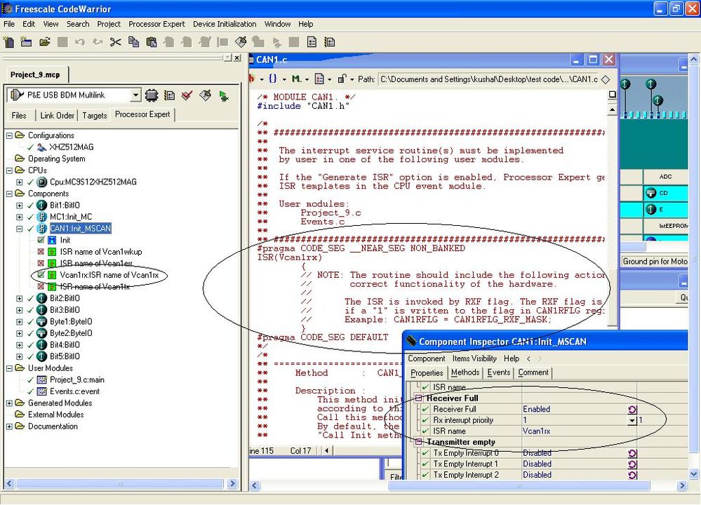

kdn
My CAN interrupt is not getting on, Is there something I am missing?

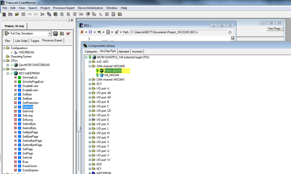

Hi KDN,
regarding to your original problem of generating ISR code. this is normal if you use init_MSCAN component.
i suggest you use FreescaleCAN component instead.

ZhangJennie
Hi KDN,
yes, you should be able to get FreescaleCAN component in "component library"
please note, FreescaleCAN is only available for professional license.
the related demo code is under: {CW5.1 install folder}\ProcessorExpert\Projects\Test projects\CAN
Zhang Jun

christianhdz
What is the difference between using "FreescaleCAN" and "Init_MSCAN"?
7,801 Views
ZhangJennie
Hi Juan
Init_MSCAN if for peripheral initialization. FreescaleCAN component includes all the feature of Init_MSCAN components, besides, it also includes selectable methods for the component runtime API.
Init_MSCAN is supported by all kinds of CW license.
FreescaleCAN is only supported by professional edition license.

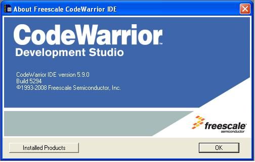

kdn
I am using this version, is this possible in it.
