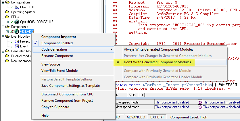

ZhangJennie
Hi David,
Roughly, we can classify processor expert components as CPU component and non-CPU component.
for non-CPU component (for example ADC component), we can right click then choose "don't write generated component modules". thus all this component generated files will not be overwritten.
However this feature can't work for CPU component.
Does this answer your question?
