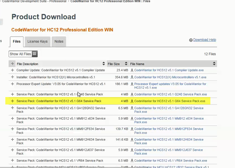

MC9S12G64在 CodeWarrior IDE 5.1免费版里面找不到这个IC是什么情况?初次接触飞思卡尔,求大神们指导,谢谢啦
7,876 Views
ZhangJennie
you need install CW5.1 for hcs12 G64 service pack. attached document is for where to download it.
I also attached it here for your convenience.
can this help you?
Jennie Zhang
7,877 Views
ZhangJennie
can this help you?
Jennie Zhang

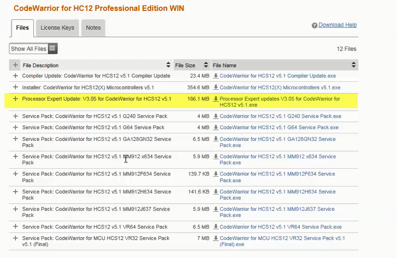

xwj
the following servicepack must be installed before installing this servicepack
processor expert v3.03 service pack
这个文件从那里下载 processor expert v3.03 service pack
7,875 Views
ZhangJennie
processor expert v3.03 is no longer available for download. processor expert v3.05 covers v3.03. you can download and install processor expert v3.05 instead. here is the download:
please refer the video in my previous post for where to access this link.
