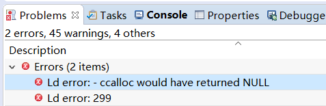

Ld error: - ccalloc would have returned NULL

What is the reason for this err?

It looks to me that the linker (ld) is running into a problem while trying to get memory allocated.
Does it happen to you for other projects too? I think your linker file must use something special or must be very big somehow?
I'm affraid that you would have to try to reduce/change the linker file to find out what is causing this.
On a side note: it would be useful to know the Version of CodeWarrior and target used. You might exchange the toolchain/linker to see if this has a positive effect, but tinkering with the tool chain would need expert knowledge.

The reason  is now confirmed that the RAM of my codes is over 60k.But I have another question about RAM_L and RAM_U.

I just solve this problem temporarily,  I correct the value of the stack size , heap size and  and  M_VECTOR_RAM_SIZE .
It does work! This correction method  is approved useful!
But I do not know the real reason.
