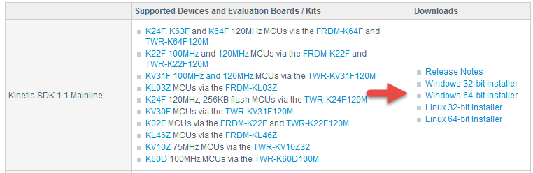

Jorge_Gonzalez
Hello Pietro:
That link you shared is for an Eclipse Update of a previous KSDK version.
The KSDK page is in this link: Software Development Kit for Kinetis MCUs|Freescale
The package you need to install is KSDK v1.1. Then click on the right version for your machine (Windows or Linux 32/64-bit):
Once downloaded and installed, please follow the instructions in the PDF of my previous message.
Regards!
Jorge Gonzalez
