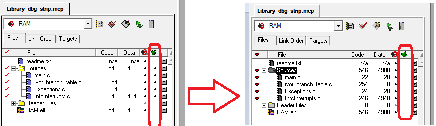

I have created a code warrior library project to generate a library as output. The library has .debug section which I would like to strip before using this library in any other project.
Is there an option available in the Code warrior IDE to strip the library of its .debug section?

Hello Prashant,
You can disable debug information for specific file or entire group by removing a black dot icon (you can on/off debug info by double clicking on the symbol) in the debug column in the Project manager (see attached screenshot below).
This should work in all CodeWarriors based on Classic IDE.
Hope it helps.
Stan.

Thanks Stanislav. This resolved my problem.

You should be able to use the strip program for this:
https://sourceware.org/binutils/docs/binutils/strip.html
You find the program in
C:\Freescale\CW MCU v10.6\Cross_Tools\arm-none-eabi-gcc-4_7_3\bin
Erich

Thanks for your quick response. The CW installation you referred to is for ARM.
I am using a Power PC installation of the Code Warrior for MSP56xx and do not see a similar strip utility being available in the package.
