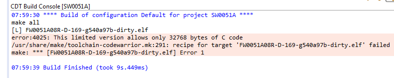

I have just join company that use Eclipse IDE with CW compiler. The computers are running Win7, 32 bit.
We have installed also CW for HC12 V4.5.
We have 3 usb dongle V5.95.
We run Eclispe luna. ok,
I follow the company usual installation procedure to get the correct version of dongle driver
But when i try to compile my code, i get error4025: This limited version allows only 32768 bytes of C code.

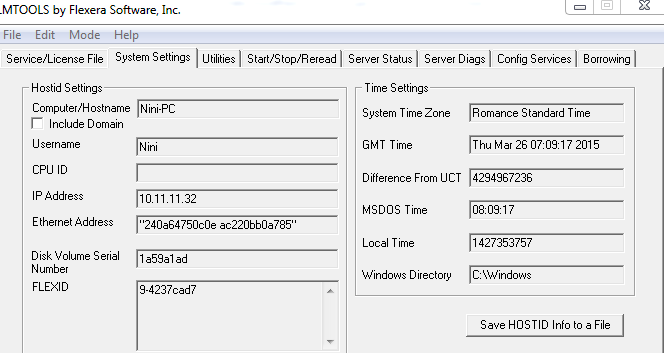

To check if the dongle is identified by my pc, i try with the lmtools
and i can see the FlexID.
But still not compiling my C code. Can you help me please? What i am supposed to do to overcome this situation?

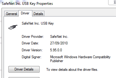

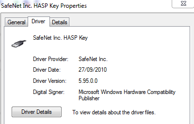

Hi Pascal,
thank you for your answer.
A particular thing I do not get is that all the 3 usb dongle perform well on the pc of one my colleague who is running window 7, 32 bit the same as the mine, using CW for h12 v4.5 libraries, and the driver version 5.95.
"The new driver is working for Windows 7.
If you install it, the USBdongle will work for the build tool chain only.
So you could use it to build your application."
In my case, i just need to use it for the build tool chain, so i would like to solve the problem by this way.
