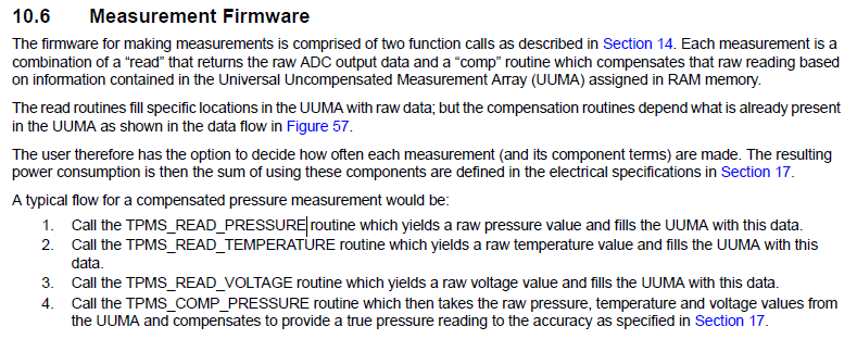

Hi, can someone please share the code for getting pressure and temperature sensor values from FXTH87xx00 series in codewarrior IDE? How do I display these values? Do I have to connect it to an external monitor or can I view it on my computer also?

HI Divyank,
FXTH87 has a set of measurement routines. We can check them in datasheet. I extract them as below:
You can also find demo code from
FXTH87|Tire Pressure Monitor Sensor|NXP
demo codes are also listed there.
If memory view in my previous video can't match your  requirement, you can use NXP Sensor GUI from here
For more question about FXTH87 MCU, (This space is for CodeWarrior IDE) I would suggest you post your question to Sensors . We have many sensor engineers who are experienced in sensor for that space.
