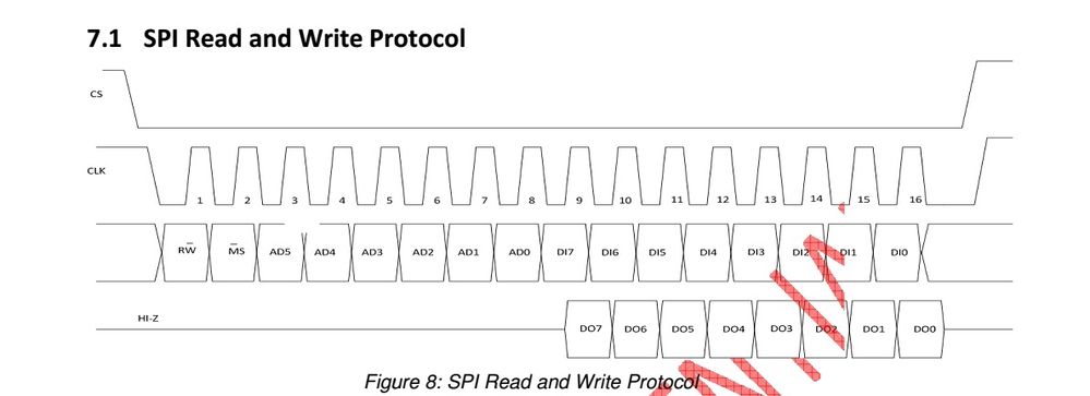

attached Image shows the timing diagram for SPI sensor

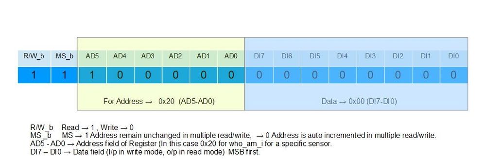

And the register values for read/write operation is given below
Right now I wanted to extract values from 0x20 for that I am writing the following code, Aslo I have tried with 0x2000(i.e from the above register values 100000 00000000) instead of 0xE000 (11100000 00000000)  in the following code but it didn't work

I find your attached SPI timing is so strange, the correct one should same with below picture:
Wish it helps.
Ma Hui
