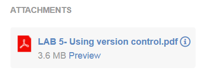

- There also a Lab about using vesrsion control on CW:
Subversion (SVN) Codewarrior 10
