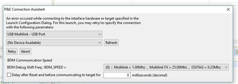

Thanks for your reply and appreciate your shared example with demo clip. I think the error message attached should b expected as i don't have k60dn512 with me right now, right?error screen shot.jpg
I am not sure what is missing right now? Or is it due to CW 10.6 configuration setting? Changing the library settings in the project properties seems like doesn't help for my case.
The sample code is modified from FRDM-KEXX Driver Library Package. So far I had tried on three of those demo codes below like ADC_poll_demo, ADC_int_demo and ADC_FIFO_demo, the same problem persists when I am trying to use printf(%f) function at console.
Appreciate if there is any other advice...
