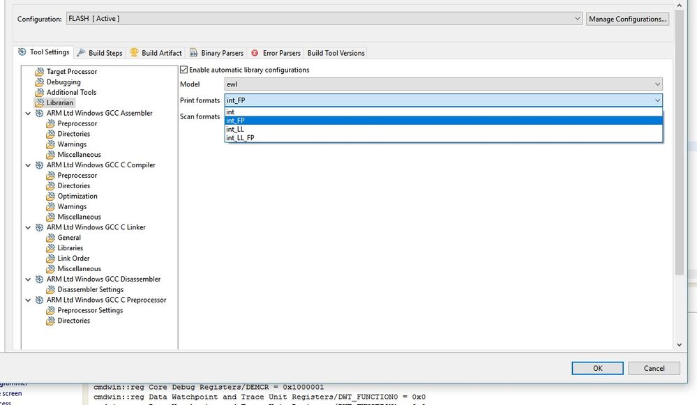

michael_galda
Hi Perhaps the issue is caused by the library settings in the project properties.
Go to:
Prj. Properties
C/C++ build -> Settings
Librarian
Tool Settings tab
See the library configuration listboxes in the window
Select the printf / scanf formats
By default it is "int"
Try to Change to FP or LL
Rebuild all
/Michael
4,942 Views
eyeow84
Hi Michael,
Appreciate your advice. Unfortunately it doesn't work for my case. I have tried all the possible options under Print formats and Scan formats and the problem still persists...screenshot.jpg
