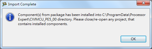

I have download GenericBitIO_1.060.PEupd and import to CodeWarrior v10.7
I close/re-open my project, that has not any change.
How to use GenericBitIO in my project?

Hello Aaron,
Do you want to add Processor Expert into bare board project (without Processor Expert) ?
If yes, please refer to: Adding Processor Expert to C Project (without SDK in PEx Driver Suite)
Hope it helps
