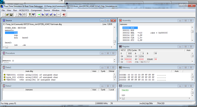

VAR00005                           388014 1 1 0  OTHER_ROM
The page 0x38 is used.
This is the debugger launched in simulator mode:

xiaoli
Thanks for your answer.
i have try ,and let the debugger launched in simulator mode. The result is the same as what you said.
But the same project, the debugger launched in "debug" mode, The result is the same as what i said before. There is nothing(even have,just 0xFFFF) ad addr page0x38. so, That's the point.
so, What can i do,  i need to into debug mode, and get the right value what i wanted, the right value as the debuger show.

Vppoff command file correctly executed.
FP: FLASH disarmed.
USB HCS08/HCS12 MULTILINK detected - Flash Version 5.84
executing .\cmd\P&E_Multilink_USB_reset.cmd
!// After reset the commands written below will be executed
done .\cmd\P&E_Multilink_USB_reset.cmd
Reset command file correctly executed.
executing .\cmd\P&E_Multilink_USB_postload.cmd
!// After load the commands written below will be executed
RESET
done .\cmd\P&E_Multilink_USB_postload.cmd
Postload command file correctly executed.
main 0x403E T
The project using DP512 generates similar problem whereas with DT256 device it's working fine.
I don't think there is a problem with the fpp file as it's working fine on my side.
Does the problem is linked to the interface ?
Please can you provide me the same command dialog you get on your side.
It could be interesting to compare the flash version used.
Another test you can do: select DP512 instead of DP256.
