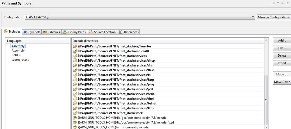

joelesco
Hi Zhang Jennie !
I have exactly the same problem ! When I include path I obtain inresolved inclusion but my project works, but a lot of include still underlined !
I saw in the paths and Symbols something strange. There is two assembly, is it normal ? More over the 3 last folder are warning? are they necesary ?   :
Thanks a lot !
4,025 Views

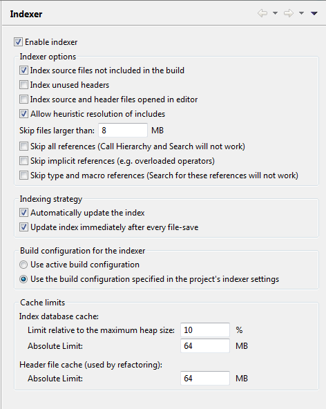

philmalessa
Hi Jérémie Lescaudron,
I had the same problem a few days ago.
I kind of found a solution for me.
In my case it was a missing checkbox in "Allow heuristic resolution of includes".
You can find it in the workspace settings:
     - Open the Project Properties
     - Click on C/C++ General -->Indexer
     - Don´t select "Enable project specific settings", but click on "Configure Workspace Settings"
This is my selection on this page.
Then rebuild your Index and it should be fine!
EDIT: I have two "Assembly" includes, too.

joelesco
Hi Phil,
I 've tried  your solution and now it works ! I think it's the "index unused headers" tick wich resolve the problem !
Thanks a lot for your help !
