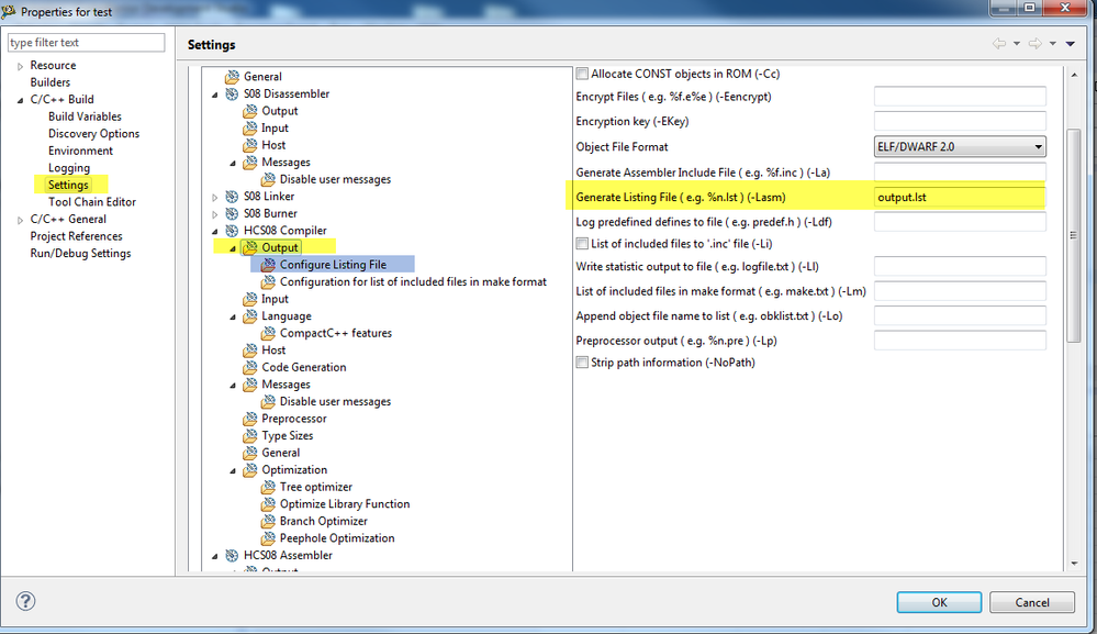

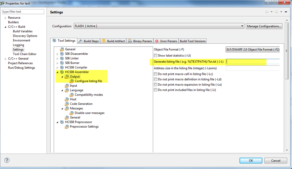

Hi Chris,
in addition, we can also set "generate listing file" in compiler settings.
setting "Configure listing file" can define what shows in lst file.
if you use assembly, you can also set "generate listing file" in assembler setting.
does this answer your question?

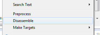

Hi Chris,
I'm not sure what you mean.
But if you want to careate a disassembly listing, simply use the context menu on the source/Editor view:
I hope this helps,
