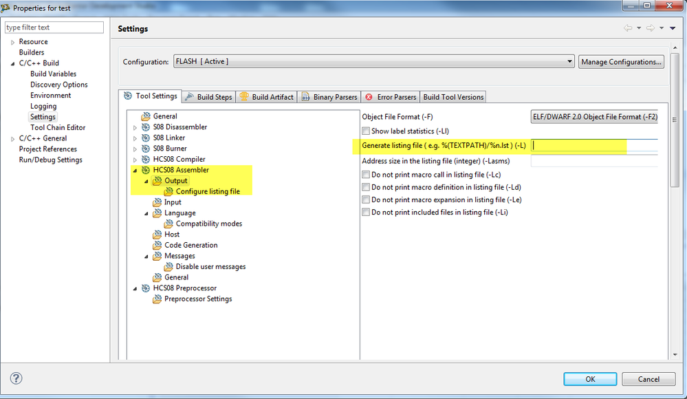

in addition, we can also set "generate listing file" in compiler settings.
setting "Configure listing file" can define what shows in lst file.
if you use assembly, you can also set "generate listing file" in assembler setting.
does this answer your question?

Hi Chris,

Thank you both for your help. I'm a bit careless lately...:smileyplain:
