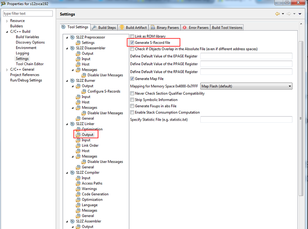

Hi ,
I am using S12ZVCA192 controller,please guide me how to generate the S19 executable file using code warrior.
What are the steps  to follow in order to generate S19 file in codewarrior 10.6.4.

Hello Kiran,
Please enable the "Generate S-Record file" :
then  build , you can find one .sx file :
Hope it helps
Alice

hi Alice
Thank you it worked out for me
