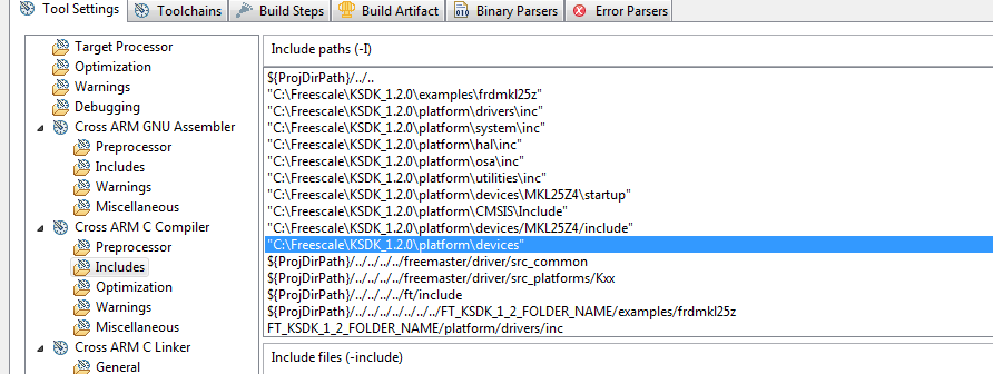

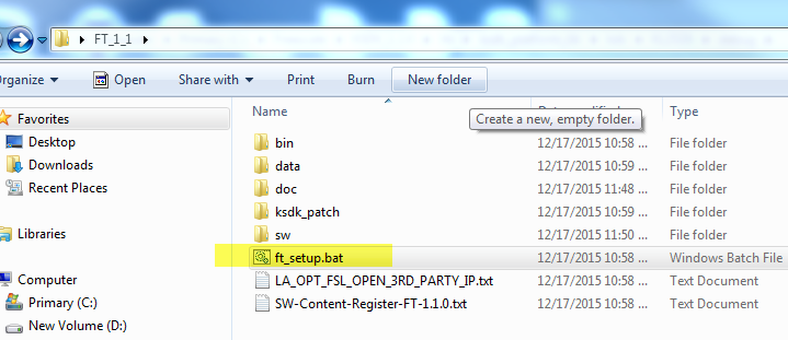

I just tested ..FT_1_1\sw\examples\frdm_aslider_app demo code included under   NXP Touch Software Library v1.1   from my side under kds3.0. now it can pass build and run well from my side on FRDM_KL25 board. see attached video
please check below points:
1. make sure you run ft_setup.bat to install the necessary files to ksdk install folder
2. rebuild lib C:\Freescale\KSDK_1.2.0\lib\ksdk_platform_lib\kds\KL25Z4
3. open project for example ..FT_1_1\sw\examples\frdm_aslider_app
in project properties, C/C++build, settings, Cross ARM C Compiler, Includes, make sure you have all the related KSDK source/inc folder included.
4, check project properties, Resource, Linked Resources, linked resources tab, make sure all the related resource locations are correct.

I was looking for an alternative solution, I came accross Freescale Touch Library(http://www.nxp.com/search?proxystylesheet=nxp_search_style_fe&oe=UTF-8&ie=UTF-8&ud=1&output=xml_no_d... ) which has different interface unlike TSS 3.1, So it would be helpful if you can provide an example for Freescale Touch Library V 1.1 using code warrior  or any IDE.
There were few examples provided by FT V1.1 for KDS, I tried them with KDS but they are not getting complied , so it would of great help if you can provide an example with FT V1.1  for KL05Z32 for any IDE ( a basic example will do with basic keypad configuration ) . FT v1.1 solution is very crucial for me.
