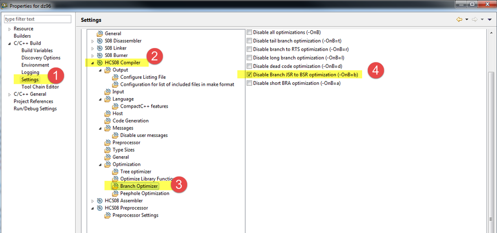

I am using freescale microcontroller mc9s08dz96, CodeWarrior development studio 10.2.
I started facing difficulty to program and debug since project code size has increased beyond 32K. I am using small memory model and till now I was able to keep my code in flash ROM_4000 & ROM_C000. To accommodate some more code I want to use flash ROM_8000 portion of memory.
When I tried to use ROM_8000 in small memory model, I faced following issues.
 1. I could not program the .s19 file on target correctly. I am using PE Micro usb multilink interface.
2. I could not debug the code. Due to some problem in copydown segment in startup,c, It was looping back/reseting to start location.
What is the correct way to use the flash memory ROM_8000 so that I can program and debug project using CodeWarrior studio?

hi,
in 9s08dz96, there are three segments of unbanked Flash ROM
    ROM                      =  READ_ONLY    0x4000 TO 0x7FFF;
    ROM1                     =  READ_ONLY    0x1900 TO 0x3BFF;
    ROM2                     =  READ_ONLY    0xC000 TO 0xFF7F;
from my understanding, you used ROM and ROM2. do you use ROM1 also?
if not, please also place ROM1 to DEFAULT_ROM.
To use "ROM1,ROM2" as well, pass the option -OnB=b to the compiler
if all ROM, ROM1 and ROM2 are not enough for you, I suggest you use bank memory mode. because flash memory from 0x8000 is banked memory, we can't use it as unbank.  to use flash memory from 0x8000, I suggest you create a new project with wizard with banked memory support, then port your code to the new project.
